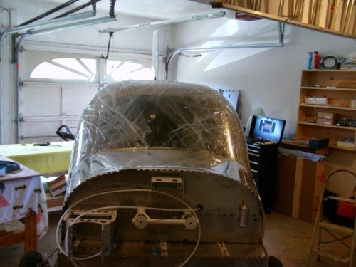

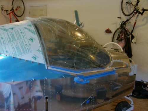

Applied strips of tape over edges of attach angles. With Denise's help, temporarily did a trial fit of canopy. The fit was pretty decent and trimming looks to be minimal but still a bunch of work to do. Only had limited time tonight so the chore of measuring and trimming will have to wait for another day.
Canopy RH Side
Canopy RH Side
Canopy Front
Canopy Front
