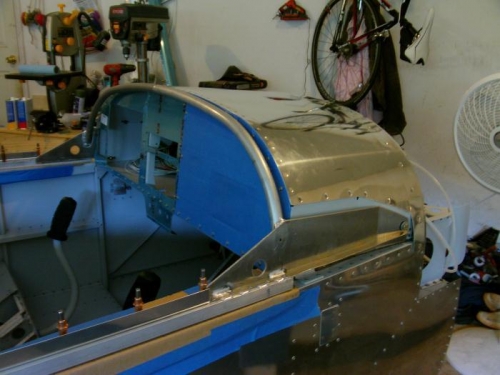

Brief Description:  Attached Canopy Frame
Tightened screws securing LH, center, and RH instrument panels.
Removed canopy gas struts from canopy frame. Did this based on other builder experiences with difficulties removing canopy after fiberglass layup.
Finished deburring edges of canopy aft bow. Reinstalled corrugated cardboard on longeron contour and temporarily installed canopy frame (including clamps and spacers).
Canopy Frame Installed
