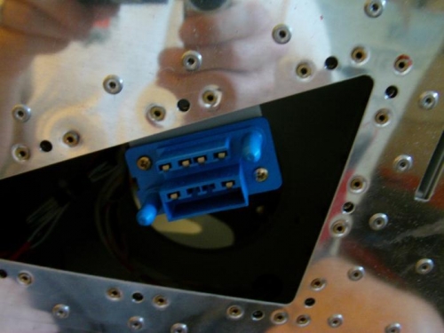

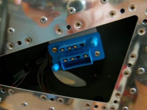

Receiver confirmation from Van's that the location for the landing light pulse wire in pin 3 for the RH fuselage connector was incorrect. Pulse wire should have been inserted into pin 5. Moved yellow wire in RH fuselage connector from pin 3 to pin 5. Inserted wires into called out locations in RH wing connector. (page 31A-04, step 10).
Page 31A-04 is complete.

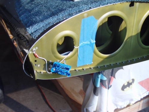

Connected RH wing connector ground wire to rib and connector to standoffs. (page 31A-05, steps 1 and 2 - RH wing).
Page 31A-05 is complete.

RH Wing Connector
RH Wing Connector
Fuselage Connector pins - Wrong Pinout
Fuselage Connector pins - Correct Pinout
