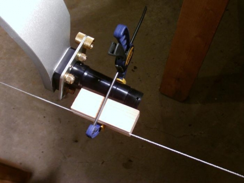

Brief Description:  Installed LH Main Gear Axle Shim
Received U-00013B shim (1/2 degree toe in) from Van's. Removed the LH gear axle and brake plate, installed shim, and re-installed the brake plate and LH gear axle. Torqued nuts and bolts. Rechecked alignment and totally pleased with the results. The string aligns perfectly with the alignment blocks on both sides.
LH Axle With Shim
LH Axle With Shim
