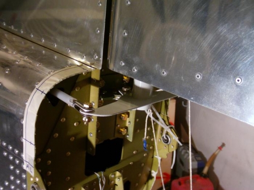

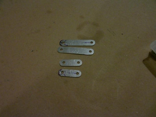

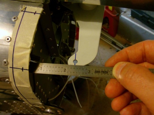

Installed rudder pedal rigging stop between pedal blocks and F-1202F bulkhead. Centered rudder and verified that distance between each bolt hole in rudder horns and aft bulkhead is 2-12/32 inches. Taped rudder into centered position to secure and verified centered dimension was still correct. Pulled each rudder cable link tight and marked center of each bolt hole in rudder horn. Did not clamp both links but did each independently. Removed rudder pedal rigging stop, then removed links. After disconnecting cables from rudder pedal horns, connected rudder cables to rudder horn. Fabricated rudder cable links to final configuration. (page 32-12, steps 1 through 10).
Page 32-12 is complete.
Rudder Horn at Centered Position
Rudder Cables Connected
Fabricated Rudder Pedal Links
