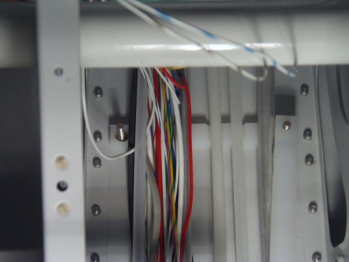

The first issue was when running the trim wires forward, it got wrapped around the fuel return line just forward of the fuel pump. Disconnected the fuel return line at the bulkhead fitting, routed the wire underneath into correct position, and reconnected the fuel return line.
Installed the fuel pump noise filter and tie wrapped to pitot tube and wire harness. Didn't have any RTV so not able to seat noise filter to bottom skin. (page 31B-22, steps 1 through 4).

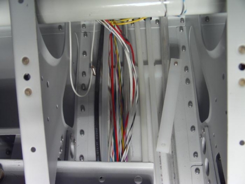

The second issue was the power outlet wire located under the pitot tube while routing the pitot tube through the F-1203A bulkhead. Was not able to seat the pitot tube into the bottom system block and needed to be corrected. Pulled pitot tube backout and aft of the F-1203A bulkhead, moved power outlet wire, and re-installed the pitot tube.
