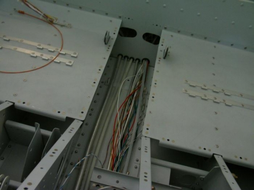

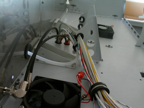

Brief Description:  Wiring - Installed Pitot Line
Routed aft pitot line forward through the F-1207D-L bulkhead channel and forward through F-1207B baggage bulkhead. (page 31B-20, step 3).
Routed pitot tube forward through bulkhead snap bushings, fuel flow transducer clamp, aft snap bushing in panel base, and bottom snap bushing of left comm support. Had a concern that pitot tube would be to short since I didn't splice it in near the left static port in the tailcone, but pitot line is more than long enough with excess wrapped around the upper engine support about three times. (page 31B-23, step 1).

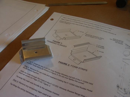

Trimmed flanges on over rudder wireway, deburred, and installed foam strips. (page 31B-25, steps 1 and 2).

Pitot Line Routed Through Tunnel
Pitot Line in Panel Base
Over Rudder Wireway
Over Rudder Wireway
