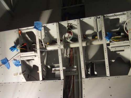

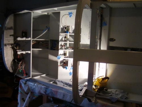

Finally figured out where the remaining option wiring harness wires needed to go. Also realized that a couple of the pitch autopilot servo wires were routed through the center section and had to be pulled forward. Routed appropriate wires to the pitch autopliot servo. Routed two spare wires to the ELT area, applied heat shrink to wire ends, and tie-wrapped to phone cable. (page 31B-15, steps 7 and 8).
Page 31B-15 is complete.
Inserted applicable wires into left and right fuselage connectors. Routed strobe synch wire between both fuselage connectors and inserted wire ends. (page 31B-18, steps 1 through 3).

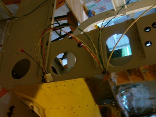

Inserted wires into Molex plug for pitch autopilot servo. Denise installed the tie-wrap through the rivet hole called out in the plans to secure wires to seat rib. (page 31B-19, steps 1 through 4).

Inserted wires into Molex plug for roll autopilot servo. (page 31B-20, steps 1 and 2).
