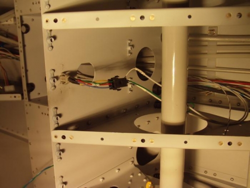

Fabricated wire run conduit and installed, along with pull strings, to center section using clamps. Installed com antenna cable and transponder antenna cable. Pulled phone cable through wire run conduit and forward to upper snap bushing of F-00027-L com support. Installed snap bushing in top of center section. (page 31B-03, steps 1 through 4).
Page 31B-03 is complete.

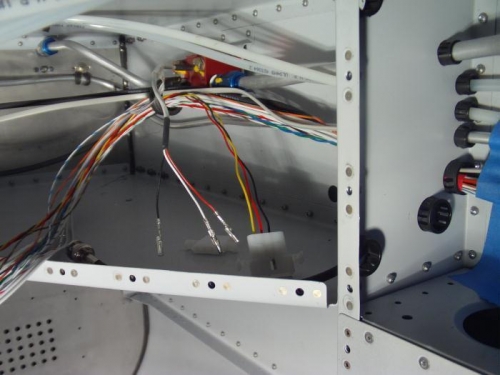

Inserted wires from fuselage harness into Molex connector for fuel flow transducer. Was not able to connect to the FT-60 fuel flow transducer because spade connectors are installed. Removed spade connectors and crimped on Molex socket pins. Also, noticed that wire colors are the same for two wires (red and black) but the thrird wire is white (from transducer) and yellow (from harness). Email sent to Van's to verify connections. (page 31B-06, steps 1 and 2).
