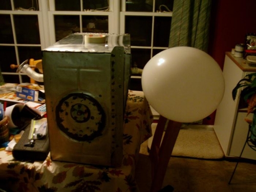

Brief Description:  Soapy Solution Leak Check of Fuel Tank
Checked the balloon when I got up this morning and it is still inflated. Let it sit all day until I got home from work and still good. Using soapy solution and small paint brush, applied solution on all seams, rivets, joints, etc. Inspected each area with a magnifying glass. Did not see a single bubble develop that would indicate a leak. To say I'm happy would be an understatement! Going to leave balloon attached and let it sit for the rest of the week and look one more time before declaring the tank leak free. (page 3-07, step 2).
Balloon Still Up in the Morning
