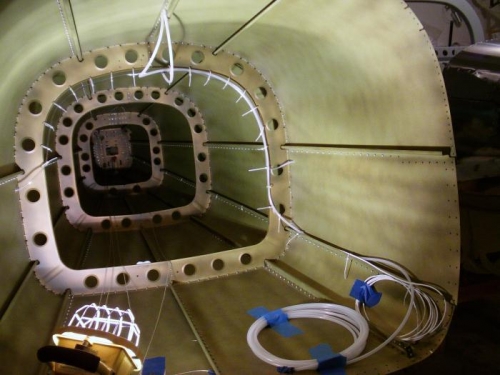

Brief Description:  Reworked Static Lines for SkyView
Used revised page 10-09, dated 10/18/11, Rev 0 (updated for installation of SkyView ADAHRS).

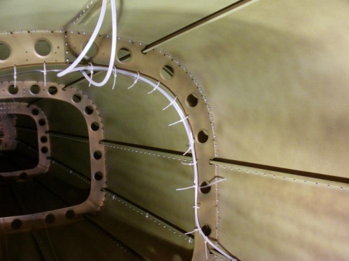

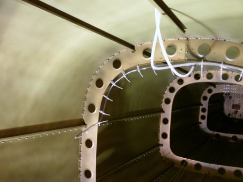

Removed original static lines (see empennage entry on 11/16/10). With the kit upgrade to SkyView, had to install static lines in a different configuration and had to install an aft pitot tube line. Installed a 24" PT 1/8 CLR PLASTIC line on each static port (sealed with RTV) and connected together at top of empennage with plastic tee. Installed static line tee upsize and used the same techinique used on original tee to install 15" PT 1/8 CLR PLASTIC line. Used the remaining original 1/8" static line as aft pitot tube and routed to top of empennage along J-stiffener and F-1208 frame. (page 10-09, steps 1 through 7).
Page 10-09 is complete.
Pitot/Static Lines for SkyView
RH Side Static Port
RH Side Static Port
LH Side Static Port
LH Side Static Port
