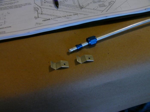

Brief Description:  Fabricated Fuel Return Line and Clips

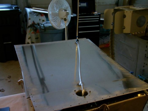

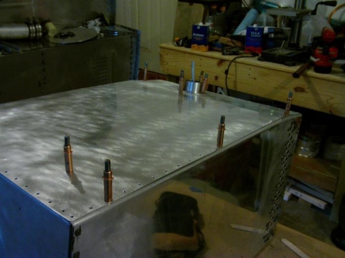

Fabricated two T-1216 clips. Connected fuel return line to bulkhead fitting, hand bent fuel return line to parallel bottom of top skin, and exited in T-1212 fuel neck collar. Clecoed clips, with fuel line, in place. (page 37-06, steps 6 and 7; didn't rivet clips yet).
Clips and Return Line
Return Line and Clips Trial Fit
Top Skin with Return Line Trial Fit
