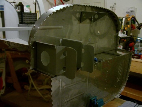

Brief Description:  Riveted Oil Tank Side Braces & Battery Mount Brace
Still waiting for sealant to arrive so the firewall perimeter can be sealed. Do not want to install panel base and make perimeter sealing more difficult than it needs to be so piddling around.
Riveted F-1201E-L & -R oil tank side braces to upper firewall. Did not rivet upper holes in each brace to keep open for panel base. Riveted F-1201Q-L & - R battery mount angles to tank side braces. (page 29-05, step 2).
Braces Riveted to Upper Firewall
Braces Riveted to Firewall
