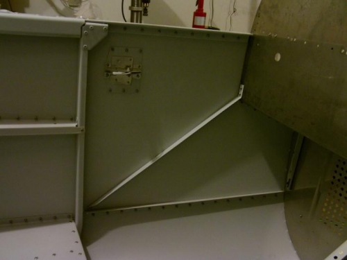

Scuffed remaining Section 29 parts with Scotch Brite pad, cleaned with Acetone, and primed.
Riveted F-1202N-L & -R forward skin stiffeners to fuselage side skin and upper firewall (page 29-03, step 5).

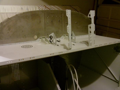

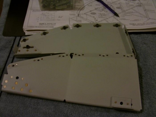

Riveted nutplates to battery mount angles. Built up canopy ribs by riveting nutplates, canopy attach doublers, and strut attach angles. Installed nutplates on aft flange of panel base and F-1202J-L & -R instrument stack angles. Riveted engine mount brackets, F-1202J-L & -R instrument stack angles, and F-1202K-L & -R instrument stack supports to panel base. Inserted snap bushings in F-1202K-L & -R instrument stack supports and panel base. (page 29-04, steps 6, 7, 10, and 11).
Forward Skin Stiffeners
Built-Up Canopy Ribs
Panel Base Assembly
Panel Base Assembly
