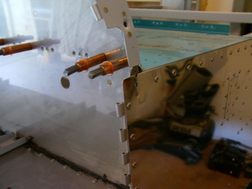

Match drilled and riveted mid cowl hinges to firewall spacers and fuselage side skins (page 29-03, steps 2 and 3).

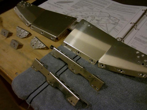

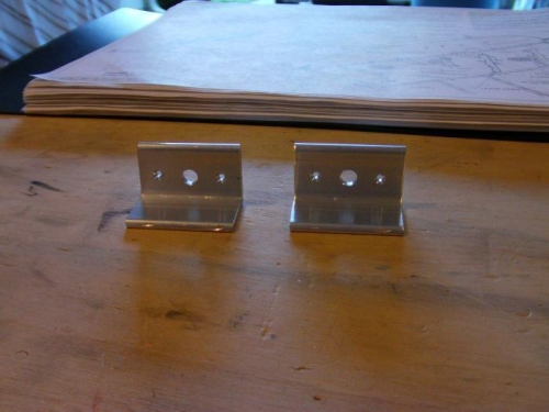

Fabricated F-1202Y strut attach angles. Machine countersunk F-1202H-L & -R canopy rib flanges and instrument stack angles, dimpled rivet holes in canopy ribs, dimpled #8 screw holes, and machine countersunk canopy attach doublers. Clecoed canopy attach doublers and strut attach angles to canopy ribs and final drilled 1/4" holes. Disassembled and deburred. (page 29-04, steps 4, 5 and partial step 6).
LH Mid Cowl Hinges
Fabricated Strut Attach Angles
Canopy Ribs & Misc Parts Prepped
