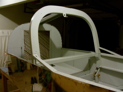

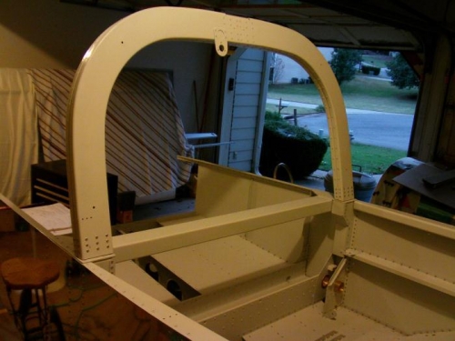

Brief Description:  Completed Roll Over Structure
Drilled #12 hole in bottom of roll bar for cockpit light. Drilled 3/8" hole in right roll bar attach plate. For some reason, do not have the called out bushings so could not complete the light. (page 40-11, steps 1 and 14).
Riveted roll bar assembly to roll bar bases (page 24-03, step 5).
Page 24-03 is complete.

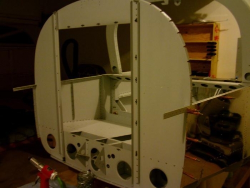

Riveted nutplates on aft baggage bulkheads and bulkhead channels. Riveted assembly to F-1207B baggage bulkhead and baggage floors. Installed bushings in left bulkhead channel. Installed and riveted roll bar brace to roll bar assembly and baggage bulkhead. Finally, installed F-1207K brace angle. (page 24-05, steps 3 through 6).
Page 24-05 is complete.
Riveted nutplate to F-1207J attach angle, then riveted angle to F-1207C-R baggage bulkhead. Riveted F-1254-L & -R support frames. (page 24-06, steps 2 through 4).
Page 24-06 is complete.
SECTION 24 ROLLOVER STRUCTURE & F-1207 BULKHEAD IS COMPLETE
Roll Bar Riveted
Roll Bar Riveted
Aft Baggage Bulkhead Riveted
Complete Rollover Assy & Bulkhead
