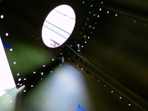

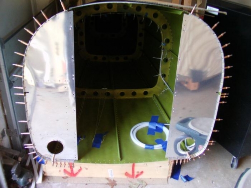

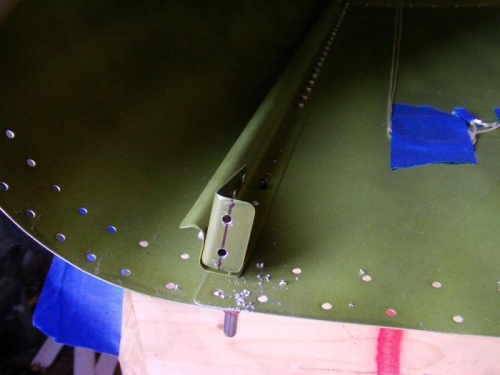

Opened up tailcone assembly for the first time in almost a year. Prior to sealing, installed dessicant. Condition of tailcone on the inside was excellent. Marked a centerline on F-1284-L & -R shear clips. Clecoed F-1207C-L & -R baggage bulkheads to tailcone assembly and match drilled the holes in each bulkhead into the shear clips. (page 24-04, steps 1 through 3).
Page 24-04 is complete.
Dimpled F-1207A baggage bulkhead, F-1207C-L & -R baggage bulkheads, and F-1207D-L & -R baggage bulkhead channels. Fluted flanges of F-1207C-L & -R baggage bulkheads. (page 24-05, steps 1 and 2). Also, machine countersunk the upper side of roll bar brace (page 24-05, step 5 - partial).
