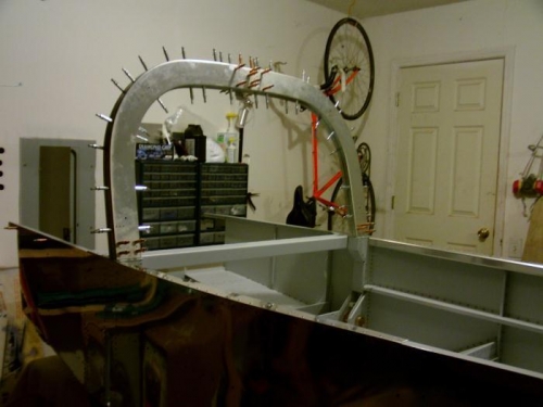

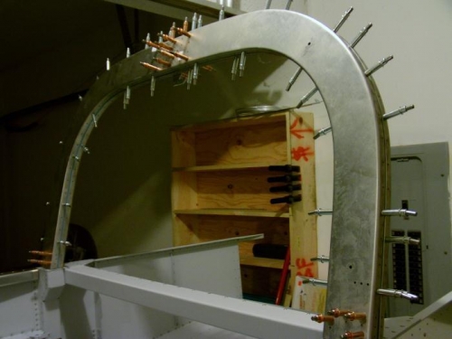

Laid out parts for Section 24.
Deburred F-1231B & C roll bar straps, F-1231A (FL, FR, AL, AR) roll bar frames, F-1231E splice plates, and F-1231F latch plate. Assembled all parts and clecoed together (page 24-02, step 1). Also, temporarily installed roll bar bases and trial fit roll bar assembly. Fit was tight but it did fit.
Roll Bar Assy Trial Fit
