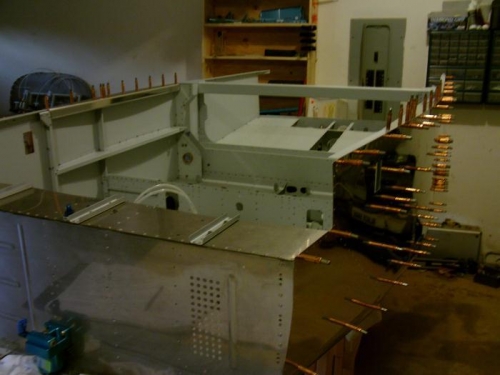

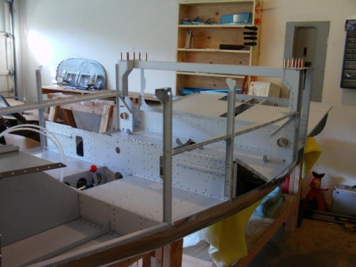

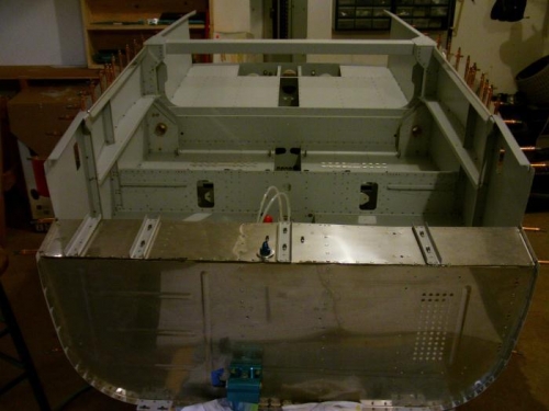

Riveted gussets to F-1202E-L & -R bulkhead side channels. Installed nutplates to fuselage skins around triangular opening. Assembled longerons, canopy decks, and fuselage side skins and secured wih clecoes. (page 23-06, steps 1, 5, and 6).
Framed Up
Framed Up
Skinned Up
Skinned Up
Skins Ready to Rivet
