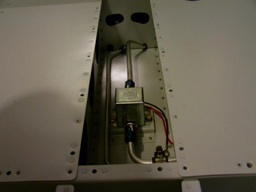

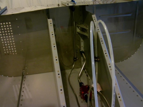

Received 1/4" aluminum tubing from Van's. Decided to redo the forward fuel return line because not happy with how it originally turned out; too many twists and turns (see 9-24-11 entry). The replaced return line turned out much better. Glad I decided to replace it instead of accepting the original installation. Also, screwed up the original aft return fuel line which is why I had to order more tubing in the first place. This time it turned out well. Installed pads and clamps. Tightened all B-nuts (finger-tight plus 1/4 turn) and torque striped. (page 28-06, steps 2 through 11).
Page 28-06 is complete.
