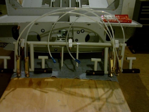

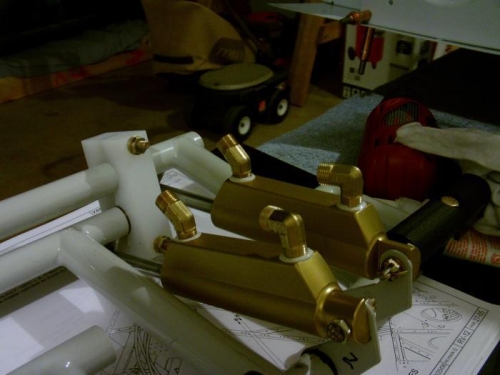

Installed brass elbows into ports of master brake cylinders. Fabricated and installed cross-over brake lines. Line nuts were torqued to brass fittings by tightening finger tight, then tightening one full turn (page 27-04, steps 1 through 5).

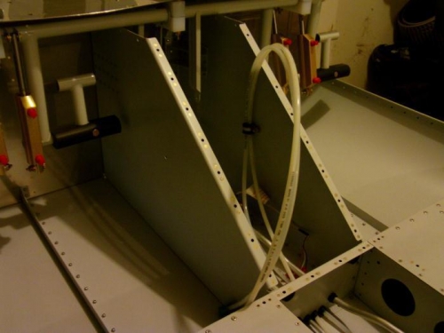

Fabricated F-1289C-L & -R main brake lines, installed nuts on aft end, and routing lines forward. Installed nuts on forward end of main brake lines. Secured main brake lines to right tunnel rib with cushioned clamp (page 27-05, steps 1 through 4).
Fabricated and installed reservoir brake lines. Line nuts were torqued to brass fittings by tightening finger tight, then tightening one full turn (page 27-06, steps 1 and 2).

Brass Elbows Installed
Cross-Over & Reservoir Lines
Main Brake Lines Clamped
