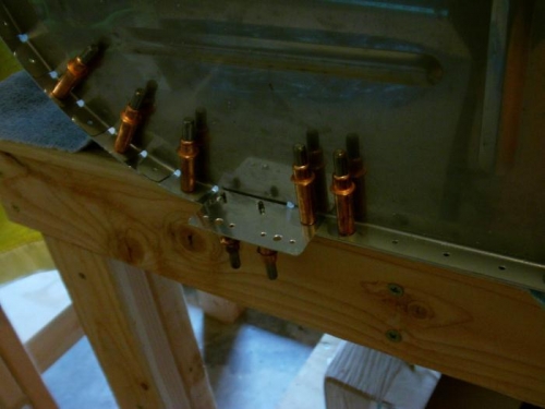

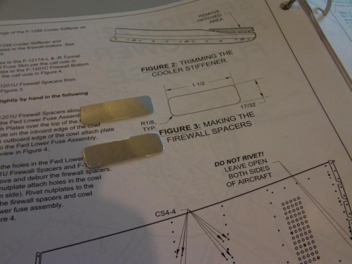

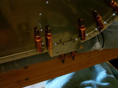

Brief Description:  Fabricated & Drilled Firewall Spacers
Fabricated firewall spacers, installed under F-12118 cowl attach plates, and match drilled. Removed and deburred. Machine countersunk nutplate attach holes in cowl attach plates (page 22-02, steps 10, 11, and part of 12).

Fabricated Firewall Spacers
LH Spacer & Cowl Attach Plate
RH Spacer & Cowl Attach Plate
