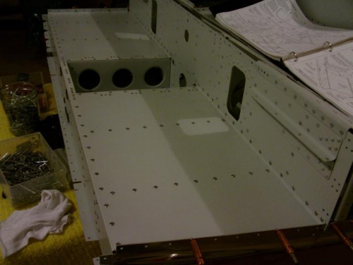

Brief Description:  Installed Steps & Step Floors
Riveted step attach angles, nutplate brackets, and F-1202F bulkhead. Temporarily installed steps to ensure everything was installed correctly and that there were no defective nutplates. Removed steps and stored for now so they are out of the way for the rest of the build. Installed nutplates at top of F-1202F bulkhead and installed bushings. (page 21-18, steps 5 through 12).
Page 21-18 is complete

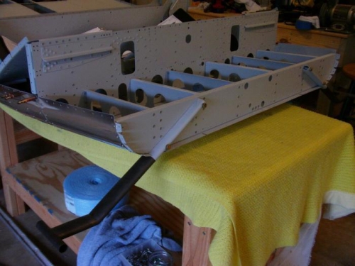

Installed nutplates on step floors, riveted step floors to ribs and bulkheads. Installed nutplates on F-1207B baggage bullkhead and riveted to F-1206G-L & -R baggage ribs. Also installed snap bushings and match drilled facet pump bracket. (page 21-19, steps 2 through 9).
Steps Installed
Steps Installed
Step Floors, Nutplates, & Bushings
