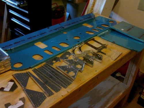

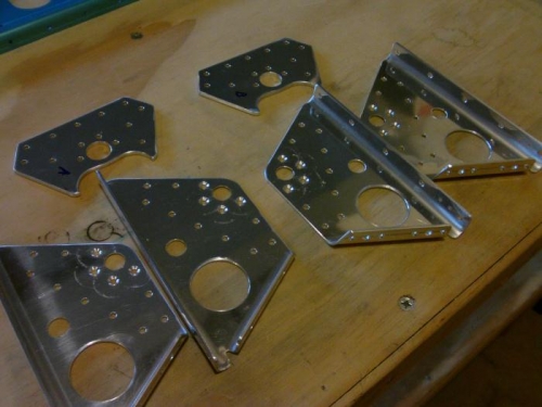

Deburred control column brackets and mount spacers and countersunk the four holes around the bearing holes and nutplate mount rivet attach holes (each bracket) (page 21-10, steps 1 and 2).
Separated bulkhead flanges, stub spar receptacle supports (page 21-10, steps 4 and 5), F-1203E bulkhead doublers (page 21-11, step 1), and F-1203J bulkhead doublers (page 21-12, step 1).
Removed blue vinyl from parts ready to deburr. These parts will support building the rest of the lower structure prior to installing fuselage corner and bottom skins.
Control Column Brackets
Prepped Parts
Prepped Parts
