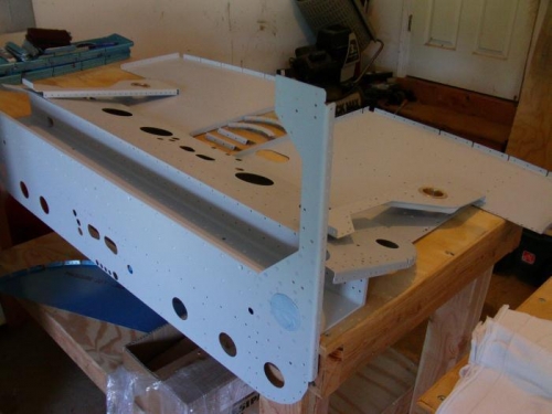

A few weeks have gone by with not much happening on the build. Denise decided that we needed to replace the kitchen floor. That's the least I can do after she helped build the wing stand on Mother's Day.
This was also my first experience with the Stewart System primer (smoke grey) and use of a spray gun. Took a little bit of getting use to but once getting the hang of it, I like the results much better than the rattle cans. Priming goes much quicker and more uniform but it does take a lot more time setting up and cleaning up.

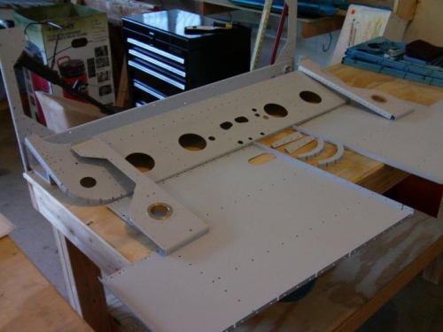

For this session, lightly scuffed center section components and baggage floors with Scotch Brite pad, cleaned with Acetone, and primed.
Center Section Components Primed
Center Section Primed
