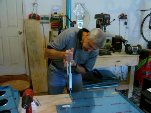

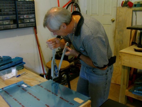

Hamp came over this morning to take a look at progress on the kit. Of course, no one comes over just to look; put him to work dimpling the baggage floors. After Hamp left, pressed on with dimpling and countersinking miscellaneous parts. Finished the following:
- Dimpled F-1224-L & -R baggage floors (page 21-02, step 1)

Hamp Doing Some Dimpling
Ditto
Ditto
