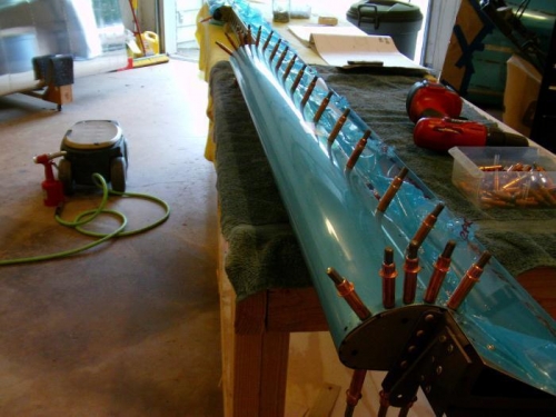

Riveted A-1201C-R outboard nose skin. Match drilled holes in A-1210-L & -R inboard nose ribs. Removed skin and deburred. Installed and riveted A-1201A-R inboard nose skin and A-1201B-R mid nose skin.
Created go-nogo gauge for 11/32" dimension for rod-end bearings. Applied thin film of Loctite 243 on first third of rod-end threads and installed rod-ends. Used gauge to establish 11/32" dimension (page 18-06, steps 3 through 6).
Page 18-06 is complete for LH and RH flaperons.

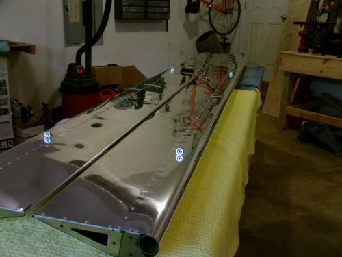

SECTION 18 FLAPERONS IS COMPLETE
