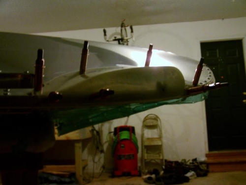

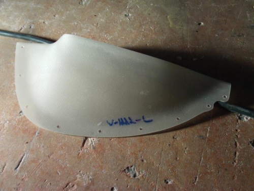

Brief Description:  Trimmed and Floxed LH Wing Light Extension

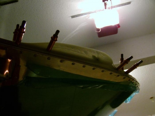

Trimmed extension W-1222-L to scribe line with Dremel and cutting disk and sanding the rest of the way with sandpaper. Fitted extension to wing tip and drilled holes. Covered light bracket hole with wax and applied car wax to wing tip rib. Mixed and applied Flox (West System 105 resin, 206 hardener, and flocked cotton) to extension and clecoed to wing tip to cure. (page 40-07, steps 1 through 6).
Trimmed Extension
Trimmed Extension
Extension and Flox Clecoed to Wing Tip
Another View of Extension
