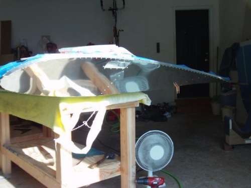

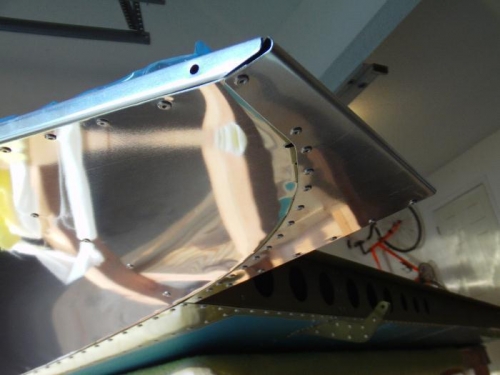

Riveted wing tip close-out W-1204D to left wing. Clecoed and match drilled wing tip trailing edge W-1204H-L, then removed and deburred and cleaned up chips. Riveted wing tip trailing edge to wing. (page 17-06, steps 2 and 3).
Close-Out Skin Riveted
Wing Tip Trailing Edge
