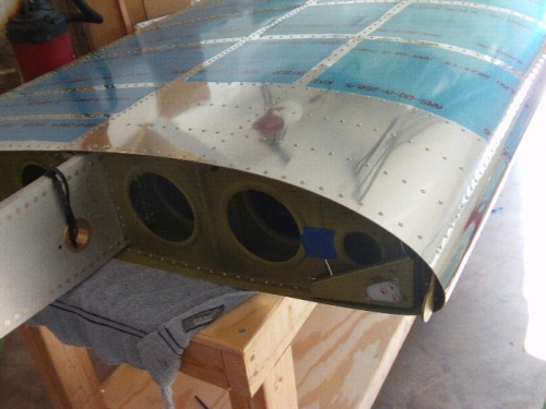

Brief Description:  Finished Left Wing Main Skins

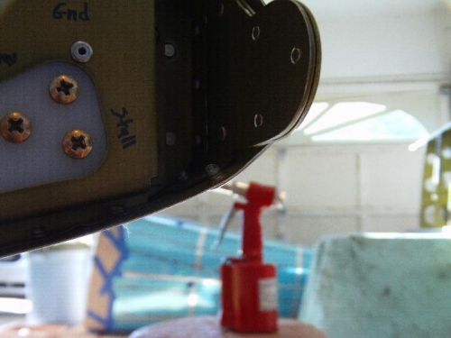

Clecoed wing walk doubler W-1201C-L to wing and riveted. Lower edges of wing walk doubler turned out better than expected and looks good. Finished riveting remaining open holes on leading edge of skins (page 17-04, steps 3 and 4).
Dimpled wing skin holes in mid lower skin and nutplates for access hatch. Clecoed nutplates to lower mid wing skin (page 17-04, step 5).
Wing Walk Doubler
Wing Walk Doubler
Lower Corner of Wing Walk Doubler
