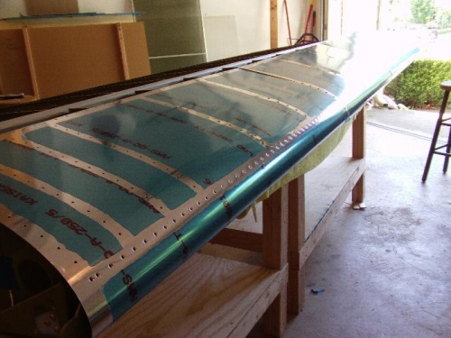

Riveted left lower outboard wing skin W-1203-L and left lower mid wing skin W1202-L (page 17-02, steps 4 and 5).
Page 17-02 is complete for left wing.
Rolled left wing assembly and riveted leading edge of W-1201-L, W-1202-L, and W-1203-L (page 17-03, steps 1 and 2. Slightly bent edge of rear spar at outer rib when turning wing assembly. Straightened with pliers and doesn't look to be an issue.

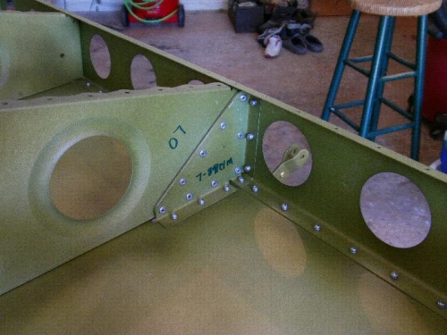

Installed both hinge brackets and hinge ribs on main ribs and rear spar (page 17-03, step 3).

Leading Edge Riveting Complete
Left Outer Hinge Bracket
