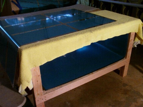

Brief Description:  Began Deburring Wing Skins
Began the next tedious deburring job - wing skins. Actually, not too bad since most of the area is flat and easy to work with. Skin sequence is in the order that they come out of the crate. Completed skins are being stored under the build tables. Deburring consists of tapping each rivet hole with deburring bit and removing sharp surfaces on the skin edges (using a 2" Scotch Brite wheel on a drill). Completed left lower mid skin W-1202-L, right lower outer skin W-1203-R, and started right lower mid skin W-1202-R.
Completed Skins Under Table
