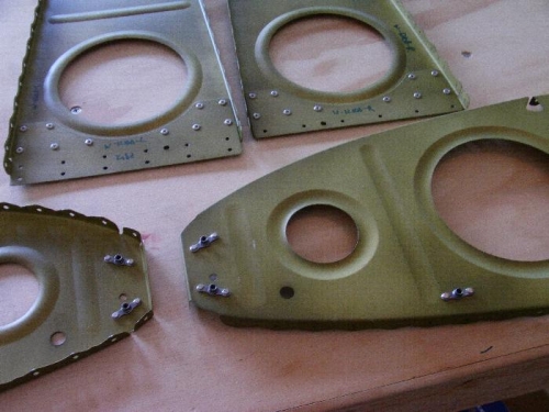

Dimpled K1000-08 nutplates and riveted on ribs where stall warning switch and terminal brackets mount (page 15-02, steps 9 and 10).
Page 15-02 is complete.
Riveted W-1210B-L & R rib doublers to inboard main ribs (page 15-03, steps 8 and 9).
Page 15-03 is complete.

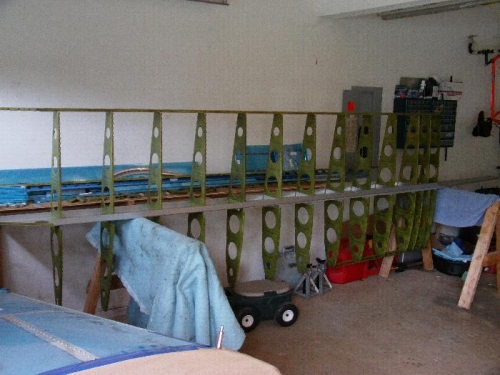

Riveted main ribs to left wing spar (page 15-04, steps 1 through 6). Clecoed left rear spar to main ribs and match drilled two holes in aft flange of inboard main rib. Riveted rear spar to flaperon hinge bracket with LP4-4 rivets. Riveted remaining main ribs to rear spar with LP4-3 rivets (page 15-04, steps 7 through 9).
Page 15-04 is complete.
Riveted nose ribs to left main spar. Used LP4-3 rivets for rib to attach angles and LP4-4 rivets for rib to spar flange (page 15-05, steps 1 through 5). Riveted left stub spar to six inboard nose ribs with LP4-3 rivets (page 15-05, step 6). Installed 14 snap bushings in nose ribs (page 15-05, step 7).
Page 15-05 is complete.
Nutplates and Rib Doublers

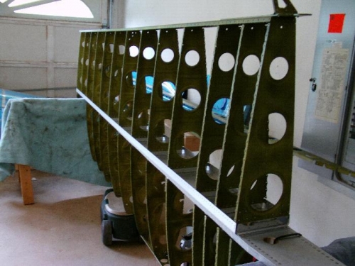

Left Wing Complete (Looking Inbd)
Left Wing Complete (Looking Outbd)
