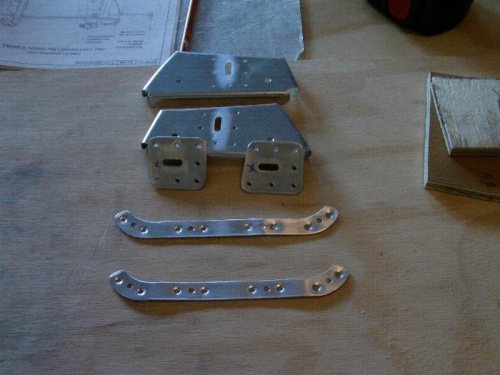

Brief Description:  Prepped Landing Light Mount Parts
While waiting for primer to arrive, decided to prepare landing light parts. Deburred and dimpled nutplate mount holes in W-1223E landing light lens backing strips (page 40-03, step 5).
Final drilled tooling holes in W-1223B landing light ribs. Separated landing light ribs W-1223B-L & -R and deburred slot. Will check alignment of ribs when trial fitting later (page 40-04, steps 1, 2 and 3) and deburred holes and edges. Machine countersunk and deburred slots in both W-1223C rib doublers for landing light ribs (page 40-04, steps 4 and 5).
