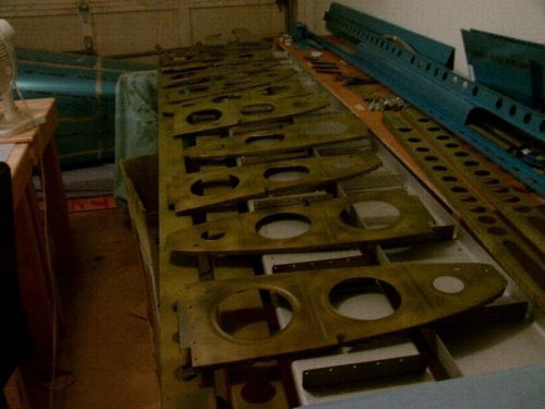

Brief Description:  Nose Ribs Primed
Fluted all 28 nose ribs. Struggled getting these to lay flat, especially on the flange side with the J cutout. We'll see how skins line up when starting to build up wings. Cleaned right nose ribs with Acetone. Primed 11 of the 14 right nose ribs before running out of primer. More primer on order.
