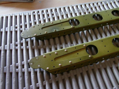

Clecoed stub spar doublers to forward stub spars. Machine countersunk the three holes at inboard end of each stub spar assembly. Riveted doublers to stub spars. Rivets turned out nice and flush on both sides of the inboard end of the stub spar assemblies.

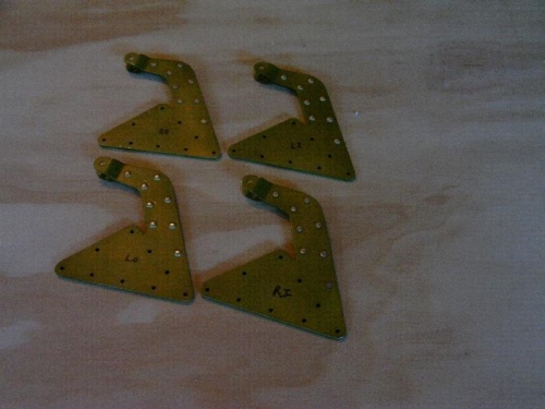

Clecoed and riveted all four Flaperon Hinge Brackets (W-1216-L & -R).
Machine countersunk holes on both sides of the Flaperon Hinge Brackets (W-1212B-L & -R). Screwed up holes on one of the brackets by countersinking too deep. Rivet sits too deep in the recess of the countersink. Need to correct this boo boo so new brackets are on order.
Forward Stub Spar Assemblies
Flaperon Hinge Brackets (W-1216)
