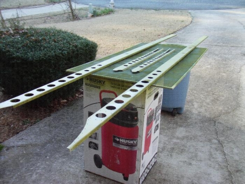

Prepped and Primed Stub Spar Channels and Rear Spa

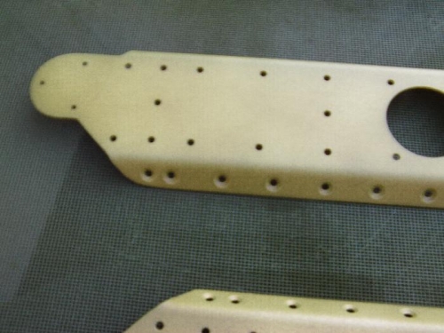

Machine countersunk W-1208C-L & -R Stub Spar Channels holes on both flanges. Lightly scuffed spars with Scotch Brite pads, cleaned with Acetone, and primed.
Primed Spars
Primed Spars - Alternate view
Countersunk Stub Spar Holes
