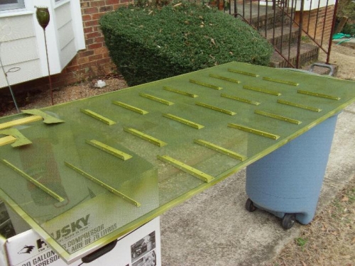

Brief Description:  Prepped Attach Angles and Doublers
Separated twenty W-1206V attach angles and two W-1206T wing tip attach angles. Separated W-1210B rib doublers and match drilled left doubler to W-1206K attach angle on left wing spar. Deburred all parts, lightly scuffed with Scotch Brite pad, cleaned with Acetone, and primed.

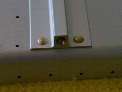

Drilled and tapped wing tie downs on both wing spars (both ends as called out in the plans).
Priming Attach Angles and Doublers

Wing Tie Down
Wing Tie Down
