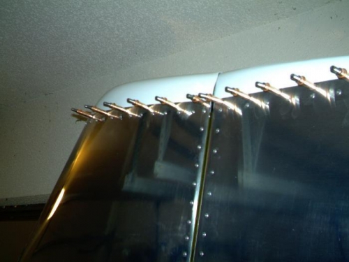

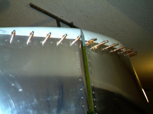

Temporarily installed V-stab tip fairing and rotated rudder in both directions. Additional trimming required on aft edge of V-stab tip fairing at top and left edge. Installed tip fairing and clecoed (page 12-03, steps 5 and 6).
Page 12-03 is complete.
