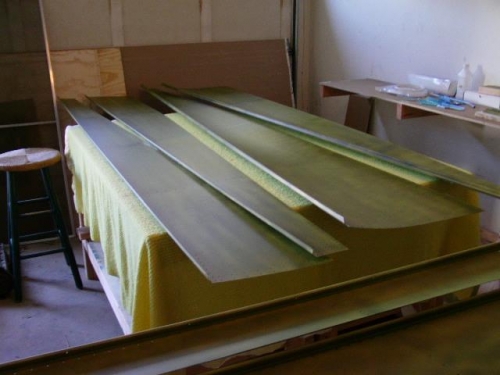

Primed Tail Cone Skins
Lightly buffed inner surface of tail cone skins witn Scotch-Brite pads, cleaned with acetone, and primed.
