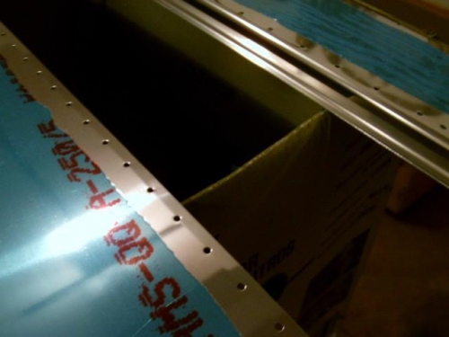

Brief Description:  Broke Edges of Fuselage Skins

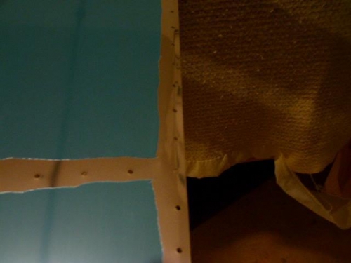

Broke edges of fuselage skins (F-1282 -R, F-1280-L &-R, F1281-L & -R, and F-1278). Used Cleaveland edge tool and generally worked well. Pleased with results. Screwed up on F-1280-R right side skin when edge of roller jumped the edge of the skin and creased the skin. The photo doesn't show the crease real well but doesn't look too bad but will decide if the skin needs to be replaced after installing and clecoing and looking at cosmetics.

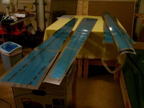

Also started removing blue vinyl from holes on outer surface of most of the skins preparing for deburring.
Skins with Vinyl Removed from Holes

Creased Edge
Creased Edge
