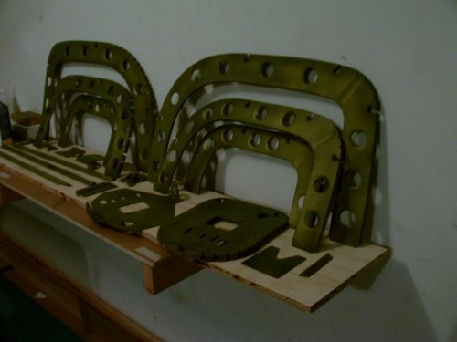

Prepared and Primed Fuselage Frames
Deburred fuselage frames, lightly buffed with Scotchbrite pad, cleaned with acetone, and primed.
Alternate View
