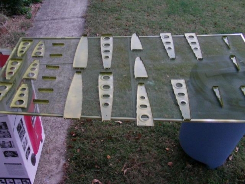

Final drilled doublers and drilled control horn hole nutplates (page 09-04, steps 1 through 4).
Riveted nutplates to hinge brackets (page 09-04, step 7).
Cut hinge stops and separated rib clips (page 09-05, steps 1 and 2).
Radiused forward inboard ribs and forward outboard ribs (page 09-06, step 2).
Cleaned all parts with acetone, lightly buffed with Scotbrite pads, and primed.

Primed Stabilator Parts
