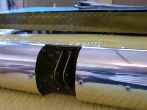

3. Temporarily installed lower rudder hinge and trial fit rudder spar assembly to V stab rear spar. Happy with the fit. Used AN960-10 washers between hinge and each hinge bracket for both the upper and lower rudder hinges. Removed lower rudder hinge, bagged rudder hinge hardware, and stored lower hinge and hardware for later use (page 07-03, step 1).

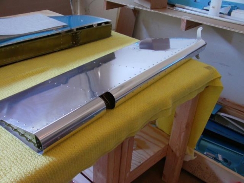

Riveted rudder spar caps, rudder brackets, and main rib (page 07-03, steps 2 and 3). This complete page 07-03.
4. Riveted trimmed rib to rudder horn, After riveting, realized that rivets probably should have been installed with rivet heads up. Decided to press on as is. Also attached rudder spar to rudder horn (rivets installed with head properly pointing forward). Finally, riveted remaining 3 main ribs to rudder spar completing rudder skeleton assembly (page 07-04, steps 1 through 3). This completes page 07-04.
5. Installed and riveted rudder main skin over rudder skeleton assembly (page 07-05, steps 1 through 4). This completes page 07-05.
RUDDER IS COMPLETE!

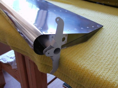

Rudder Hinge Brackets
Rudder Horn
Rudder Horn
Rudder Complete
Rudder Complete
