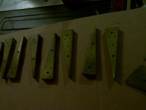

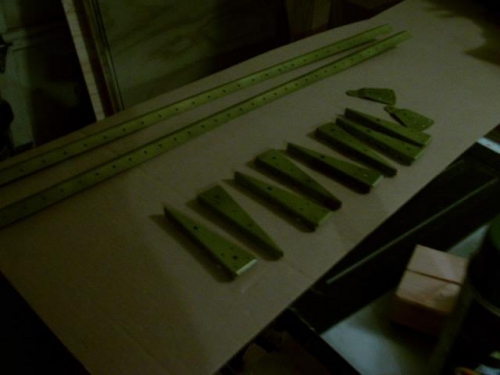

Brief Description:  Prepared Anti Servo Tabs (AST)
Completed final drill of AST ribs (page 08-02, steps 1 through 4). Waiting to complete step 5 after internal parts are primed. Also completed separation, clean-up, and countersink holes of AST Control Horns (page 08-03, steps 1 and 2).
Primed all AST ribs, both AST control horns, and both AST spars.

AST Parts Primed
AST Parts Primed
AST Ribs
AST Ribs
