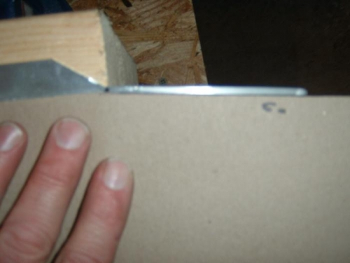

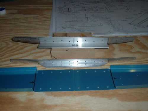

Bent the outboard ends of the reinforcement and splice angle to 6 degrees.
Marked the bend lines on the front spar assembly.
Primed the reinforcement and splice angles.
reinforcement angle
