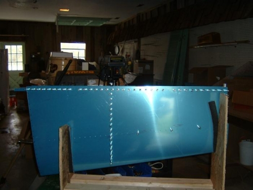

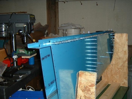

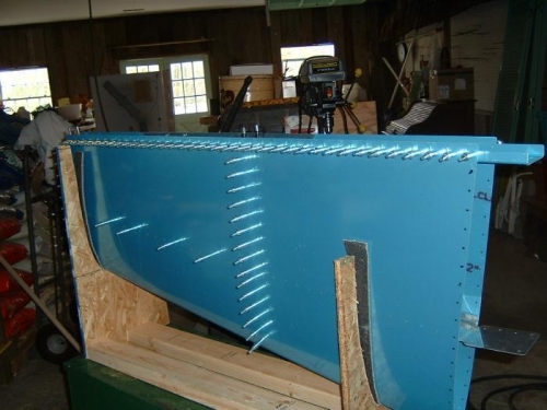

Brief Description:  drilling horizontal stablizer / cleco skin
Pilot drilled the HS-405 rib attatchment holes to #40 using demensions given in SEC D-D.
Selected left side HS-702, HS-603PP, HS-706, HS-707 and HS-708 and cleco together.
Drilled rib to sapr attatch holes to #30 (except HS-708 to HS-603PP).
Un-cleco, deburr holes, cleaned out chips and re-cleco.
Enlarged HS-708 to HS-603PP holes to #21.
Cleco on the HS-801PP skin.
Sliped the HS-404 and HS-405 ribs in place and marked aproximate hole location using skin as guide.
