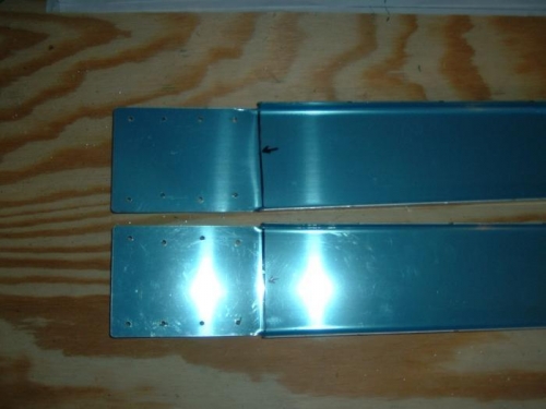

Bent tabs on forward spar as shown in View B-B page DWG 3.

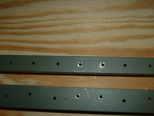

Used the DRD2 to dimple center 4 holes of foreward spar.

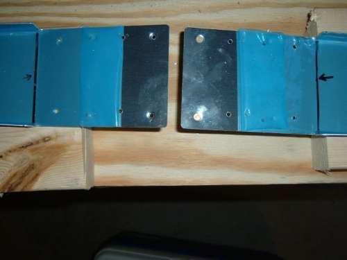

Used #30 countersink on center 4 holes of reinforcement and splice angle.
Note first time to use dimpler and countersink; practiced on scrap first.
*** Update relief holes required at bend line ***
HS-702 tabs
HS-702 tabs
HS-702 dimpled
HS-702 dimpled
countersink of angles
