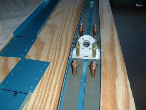

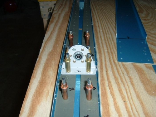

rear spar assembly
Clamped HS-411APP and HS-411BPP around VA-146 and clecoed the assembly to the spar; removed debur and rivet.
Match drilled the aft four VA-146 attatch holes.
Removed assembly and match drilled the two foreward holes and rivited.
Deburred the parts and primed the rear spar reinforcement bars.
