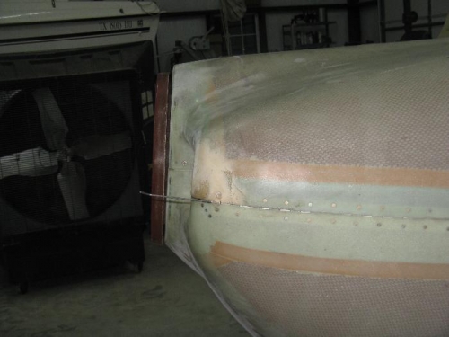

I am using the engine cowl off the RV-7A so one of the first things to do is remove the slot for the nose wheel.

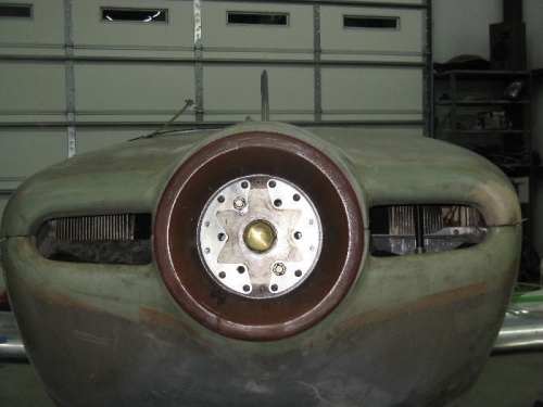

Then I put the cowl up against the firewall to see how it fits. It looks pretty good except in these pictures there is a 0.43” spacer extra behind the spinner back plate. Therefore it looks like I will need to trim about that much from the back of the cowl. I think I will need to move the front of the cowl down a little also.
Removing the nose wheel slot
Looks close
Looks close
Front view
Front view
